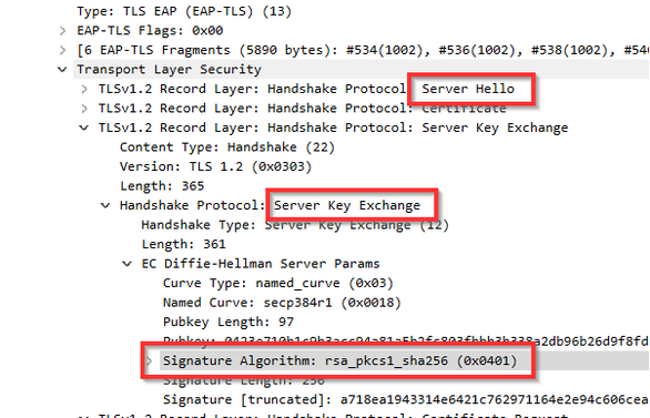

I confirm that the issue is still present also with ISE version 3.2 patch 5.
Server Hello to PC with PSS Algorith:
Server hello to PC without PSS Algorithm:
Workaround: Azure Policy to disable Signature Algoritym RSAE-PSS.
