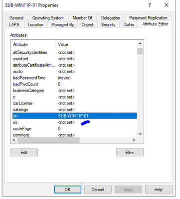

Please see the attached file.  When a Windows client connects to the network and its supplicant is configured to send the computer certificate, what exactly is the PSN doing with this certificate?  In the attached i have a use of Lab_dot1x_Certs (See 8021x-Certauth.jpg).  The configuration of Lab_dot1x_Certs is seen in the External Identity.jpg also attached.  The config of sub.lab.com can be seen in the file sub.lab.com.png.  I'm assuming that the PSN (lets say ise-04.sub.lab.com gets the cert, its role is only PSN) gets the client cert and does something with it...but what in detail is it doing?

accordingly to external identity configurations you sent,  PSN is looking the common name (CN) attribute in the certificate. If you are using Machine Authentication CN = hostname.domain , if you are using User Authentication CN = usernama@domain. and PSN lookup these information provided by certiicate CN attribute in your AD domain.

Thanks Rob.  In continuing on with the example, if a cert is presented that has the below, i'm assuming the PSN would make an LDAP call.  What's unclear to me is would it check 389 (ldap) or 3268 (GC).  In my lab i have a root AD domain of lab.com and a child domain of sub.lab.com.  It's possible the computer object could come from either AD domain. Just trying to understand the mechanics behind how the PSN gets the cert, then ask AD "Do you have a computer object with a CN=XXXXXXX" when XXXXXX could be in a number of AD domains.  But in my example, does it only ask TCP 389 or does it also ask 3268 which i would expect to have some attributes about all computer objects in the forest.   Multiple AD domains just make things difficult......
