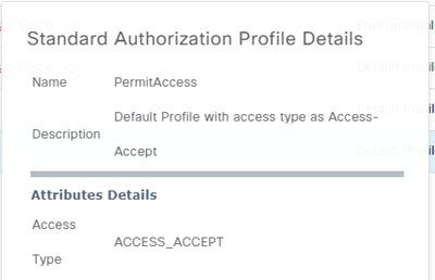

Thank you Octavian, this is really interesting, we do have a unique profile in ISE for Maintel Phones/VC units, but it hits the generic 'Permit Access' Authorisation profile.
Should the phones have their own Authorisation profile?  I can see the Default Cisco IP phone authorisation profile, but we don't use it as we don't have any cisco phones onsite, I can see that it has a DACL, and Cisco AV pair info, is this what could be missing from my 'generic' IP phone profile?
"Access Type = ACCESS_ACCEPT
DACL = PERMIT_ALL_IPV4_TRAFFIC
cisco-av-pair = device-traffic-class=voice"
Can I just add, that we do not have any issues with IP phones working onsite with the current config.
thanks
A 'normal' IP Phone uses the Voice VLAN.
The thing is that when you have 802.1x enabled, the switch will not let any MAC/session into the voice VLAN until it recevies from RADIUS the fact that it should belong to voice VLAN.
This translates to that "cisco-av-pair = device-traffic-class=voice" from ISE which is actually the check box voice vlan permissions when you look into the authorization profile from GUI.
You don't neccesarilly need that defualt cisco ip phone profile. You can create a simple profile, with no dACL, but remeber to check voice vlan permissions.
In your case, you don't have any issue because you have the authentication open command configured. If authentication/authorization fails, no one gets access denied.
BR,
Octavian
Octavian, Digging a bit deeper, I can see what you mean, we do have an non cisco IP phone auth profile, it is there, but its not been used, this could be an oversight from when ISE3.1 was setup, and because the phones 'worked' it was never checked. From memory I do remember the setting from our old installation of ISE (hence why the 'non cisco phone' auth pro is there).  It is an easy enough change, although, we have approx ALOT of phones on mab, so caution would be sensible :).  I am curious to know if this would also bring the repeat counter down in ISE. It always seem astonishingly high at 5284758!!
Thanks you for your advice.  I will let you know the outcome
DigiDen
Apologies for the late reply, as it wasn't causing us too much pain, it wasn't high priority.  However I have now changed the authorisation profile to "non cisco IP phone", which uses the following text:-
I can confirm that the switch logs are no longer filling up, and we also noticed CPU utilisation dropping on all 4 Cisco ISE boxes.
The change did not cause any outage to the IP phones.
Thanks again for all your help and advice.
thanks
