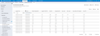

Yes - as Marvin pointed out, that is one method.  The ISE GUI also has a KPI report if you find that more accessible?
@Arne Bier
Thanks - I had forgotten they added that in the GUI as well.

could u pls explain LOGGED TO MNT/HR column meaning (value for arbitrary interval 2845)?
I guess i understand RADIUS REQUESTS as number of AAA requests during interval (seems to be 1 hour), right? it's value 17915, but what is then LOGGED TO MNT/HR which value times less?
br andy
Hi @Andrii Oliinyk ,
Logged Time: time data is collected (data collected every 5 mins is aggregated hourly)
Server: Server Name in the deployment
RADIUS Requests Per Hr: number of RADIUS Requests per Hour for selected PSN
Logged To MnT Per Hr: number of such requests logged to MnT database for selected PSN
Noise Per Hr: calculated as difference between RADIUS Request per Hour and Logged to MnT per Hour
Suppression Per Hr: calculated as percentage of Noise w.r.t. (with respect to) RADIUS Request per Hour for selected PSN
Avg Load: average server load for selected server
Max Load: maximum server load for selected server
Avg Latency Per Request: average latency per RADIUS Requests for selected PSN
Avg TPS: average transactions per second calculated as number of RADIUS Requests served per second by PSN
Hope this helps !!
