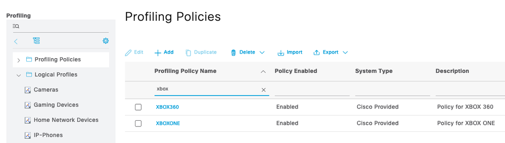

You are using the Gaming Devices logical profile which has these profiles:
Searching the ISE Profiles for "xbox" I see there is also "XBOXONE". Did you also add that? Is that not matching for you?
> the devices was not properly recognized
OK, then what device did it match? You did not provide any details so we cannot suggest corrections.
Why did it match this other device? Were there similar attributes? Were attributes missing such that the XBOX profiles did not have a match and get a higher certainty factor?
These are the profiling rules for both XBOX profiles:
XBOX360Rule1Check1 | DHCP:dhcp-class-identifier EQUALS Xbox 360
and
XBOXONERule1Check1 | DHCP:host-name CONTAINS XBOX-ONE
XBOXONERule1Check2 | DHCP:host-name EQUALS Xbox-SystemOS
XBOXONERule1Check3 | MAC:MACAddress STARTSWITH 50:1A:C5
Are you seeing these DHCP attributes for these endpoints?
Does profiling any other endpoints with DHCP work in your environment? Or is it only XBOX  devices giving you an incorrect profile?
If you do not see DHCP attributes, how are you sending ISE DHCP attributes?
These are the necessary troubleshooting details you need to figure out.
