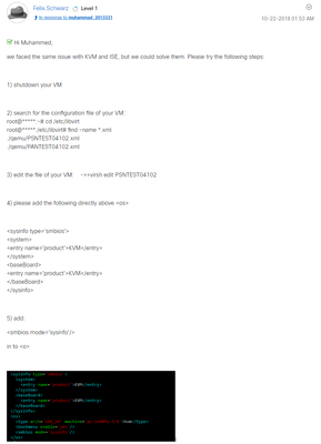

From what i see on from this link community Link,
it caused by "wrong version" of VM for HCI Environment (it shouldn't install the .ova version) :
https://community.cisco.com/t5/network-access-control/ise-2-7-license-pid-and-sn-unsupported/td-p/4293335
