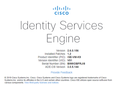

Exact same issue persists after applying patch 2.
