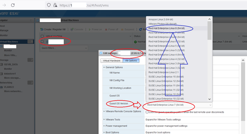

When I attempted to upgrade ISE version 3.0 (which run on ESXi 6.7) to ISE version 3.2, I get this:
application upgrade proceed
Initiating Application Upgrade...
% Warning: Do not use Ctrl-C or close this terminal window until upgrade completes.
Upgrade tomcat backup complete.
-Checking VM for minimum hardware requirements
Required ESX Version 7.0 available to proceed with upgrade
sha256sum: /storeddata/Installing/.upgrade/bundle.tar: No such file or directory
STEP 1: Stopping ISE application...
STEP 2: Verifying files in bundle...
Is this a bug or just poor documentation?
UPDATE: (I edited my previous post because I missed one final step)
I just confirmed in the lab, an ISE VM created in the UCS ESXi 6.7 Server can be upgraded with no issues. I only installed patch 10 on that VM running ISE 2.7 before the upgrade. See next:
ISE/admin# application upgrade ise-upgradebundle-2.7.x-3.1.x-to-3.2.0.542b.SPA.x86_64.tar.gz localdisk
Be sure that all your software is working stable, check your system on UI page (Administration > System > Health Checks)
Type yes once confirmed that health of the system is good to proceed: (yes/no) [yes] ? yes
Save the current ADE-OS running configuration? (yes/no) [yes] ? yes
Generating configuration...
Saved the ADE-OS running configuration to startup successfully
Getting bundle to local machine...
Unbundling Application Package...

AFTER THE UPGRADE IS COMPLETED, Based on the following instruction you must change RHEL 7 to RHEL 8. That implies application stop ise + halt via CLI, then change the settings in the VM and finally power on the VM. See next
Cisco Identity Services Engine Upgrade Guide, Release 3.2

Either this is totally false or it is a much bigger issue.
Hi Adam,
We are proceeding soon to upgrade ISE 2.7 into ISE 3.2 and I have multiple VM's with ESXi 6.7 licenses (not 7) so I am wondering how you solved this issue. (P.D: I had another VM's running ESXi 7, restored a 2.7 config backup and upgraded them to 3.2 with no issues)
thanks
I am 99.9999% sure that ISE doesn’t care (or check) what version of ESXi you have as long as you present the correct number of CPUs, RAM and disk to the underlying Linux OS. ESXi 6.7 is fine as far as the virtual hardware goes to support the boot up.

I have upgraded from 3.1 to 3.2 in production enviroment with ESX 6.0 Compatibility.
In logs "Required ESX Version 7.0 available to proceed with upgrade
Only thing that it was increased was vCPU from 8 to 12.
Guest OS:Red Hat Enterprise Linux 8 (64-bit)
Compatibility:ESXi 6.0 and later (VM version 11)
Not sure what you mean by "... with ESX 6.0 Compatibility."
Is the ESXi version 6.0 ?   would hope not.
I tend to right-click on the VM and upgrade its compatibility to the latest version that the ESXi supports.
It's ESX Version:7.0.3 with ISE Compatibility:ESXi 6.0. That's ISE check.
For VM and upgrade its compatibility it require a shutdown that's the problem on production enviroment :).
