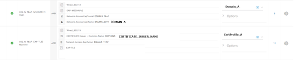

Hi @Arne Bier
I've made these 2 rules.
The first one, should match User Authentication sent with MSCHAPv2 in the TEAP  Tunnel
The second one, should match the machine certificate sent in EAP-TLS on the TEAP Tunnel
I hope when adding another domain I will be able to duplicate these rules, and therefore asking only the corresponding Active Directory server. (From what I've seen, the order seems to be important (User then Machine)
