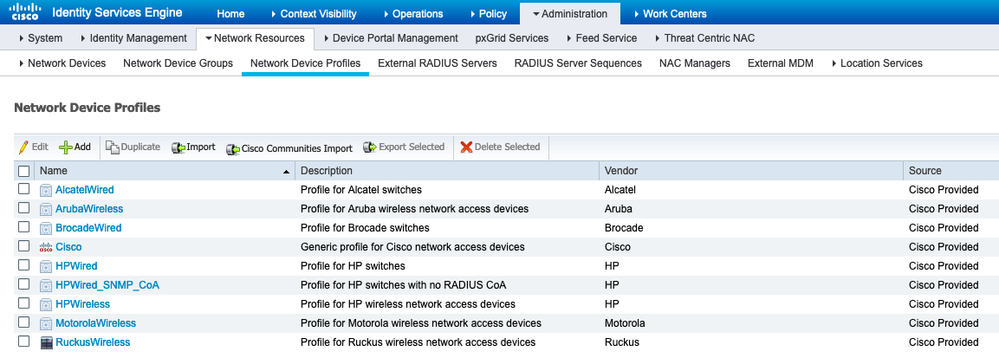

it suppose to be located under Administration > Network Resources > Network Device Profiles:
But the option Network Device Profiles is nowhere
Do I missing something?

Network Device Profiles is a base feature.
If you do not have access to it, you are probably not logged in with a SuperAdmin role.

Even the Base license suffices to add network access device profiles.
Are you logged in as admin or as a named user? If the latter, please retry logging in as admin - your account may have had restrictions applied (inadvertently or not).

Check which Admin group is assigned under your username (System> Admin access> Admin users), if you are part of Super Admin Group (which most likely is not the case).
