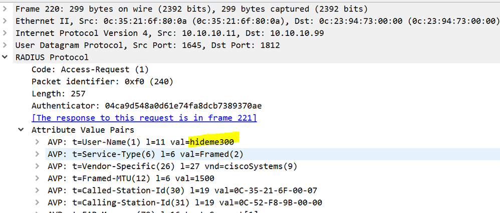

04-01-2022 03:03 PM
Hello @adamscottmaster2013
You're entirely correct. I just performed EAP-PEAP MSCHAP-v2 with a Windows 10 client where the Identity Privacy was enabled.
I configured the Windows supplicant to use Identity Privacy (to obscure the outer identity) - I entered arbitrary text of "hideme300".
This is from a GNS3 lab ... I took some shortcuts on checking the ISE cert
I logged in as "user1" when prompted by the Windows Supplicant.
The ensuing wireshark on ISE shows that in the Access-Request contains User-Name "hideme300".
But as you pointed out, the final Access-Accept to the switch contains the inner identity of user1.
From a security point of view that is possibly not what you wanted. But. Consider that the NAS (WLC/Switch) usually takes that username in the Access-Accept for display purposes to show authenticated users. It's very helpful and also very helpful for troubleshooting.
Perhaps there is an RFC somewhere that describes what SHOULD be sent in the final Access-Accept when identity privacy is used. If the RFC says that the User-Name MUST always be obfuscated, then I think you have a bone to pick with Cisco.
