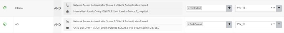

From my understanding you want on the same policy to authenticate and differentiate the authorization between AD Users and ISE Internal Users.(The AD User should not be the same as the ISE internal User).
First you need to create an Identity Source Sequence (Administration Identity -> Identity Management -> Identity Source Sequences)
Under the Authentication Policy choose the Identity sequence you have created :
And under Authorization policy should be like this :

Attached the Policy Set + The TACACS Log
