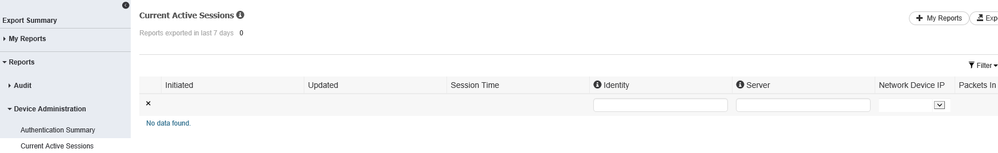

02-10-2020 03:53 PM
When i try and check for Current Active Sessions, it gives me no data found.
