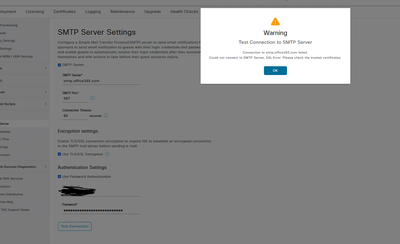

I have setup a office 365 SMTP server in ISE and the test connection is failing, states I need to import the trusted cert into ISE.
As far as I am aware I do not have this and should be downloaded from Microsoft.. cannot find details of the trusted cert anywhere online.
Can anyone assist?

You can check which root CA the endpoint uses with the following openssl command:
openssl s_client -connect smtp.office365.com:587 -starttls smtp
Since you're using smtp.office365.com according to your screenshot you will need to add the Digicert Global Root CA certificate( https://cacerts.digicert.com/DigiCertGlobalRootCA.crt.pem) as a trusted root certificate: https://www.cisco.com/c/en/us/support/docs/security/identity-services-engine-software/200295-Install-a-3rd-party-CA-certificate-in-IS.html
