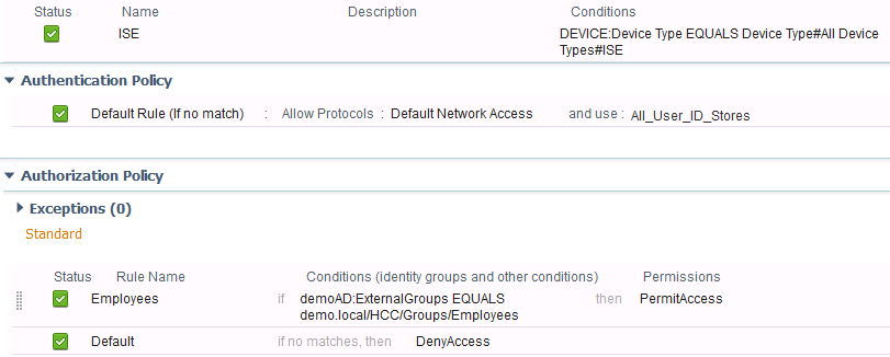

I am seeing the same problem on my ISE 2.1 and N1Kv so have asked our engineering teams to investigate. One workaround I have right now is to use ISE as a RADIUS token server and define a RADIUS policy set to deny access by default unless matching specific user groups. Additionally, a NAD created for ISE itself with the same shared secret as the token server object.
Then, update the T+ policy set for NX-OS to use this loop-back RADIUS token server as the identity source, instead.

08-17-2016 05:16 PM
