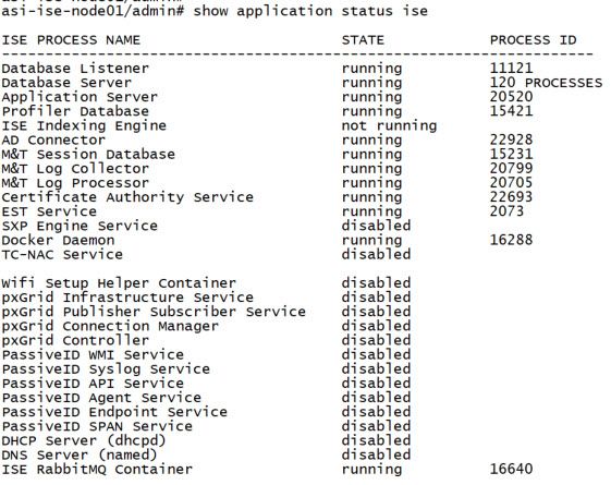

We have two ISE nodes deployed (I believe in distributed model). They are running v2.4.0.357 (with ISE patch v2). When browsing to the context visibility, we get the following error:
Has anyone run into this same error?
I noticed another discussion with a similar post, but seems a bit different than this one. Was trying to get further info, so when accessing the ISE cli, tried a couple of cmds.
Here is output I see from ISE cli about the application status:
Is the above indicative of expected behavior?

but based on techzone, when I enter the ISE cli and check the application ise-elasticsearch.log, I don't see the same errors. So not sure if it could be related or something very different.

Thanks everyone for the help. We figured out what the problem was. So we are using two ISE nodes (primary and secondary) and it seems like the secondary had it's system/trusted certs installed correctly, but the primary ISE node somehow didn't have its trusted cert added correctly. So we went to system certs, exported and reimported via the trusted certs. This fixed the context visibility issue.
We didn't need to reset ISE or reinstall or patch anything further.
