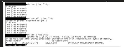

Running 16.12.05b if that makes a difference.
Config guide
First time using LLDP. The configuration guide has me believing that you have to do lldp run to enable it globally, then lldp transmit and lldp receive on the desired interfaces.
It appears "lldp run" enables it on all interfaces by default and they start processing lldp. This seems to be opposite of what the guide indicates. If I apply "lldp transmit" and "lldp receive" on desired interfaces, a show run or show run all does not show it. If I apply "no lldp transmit" a show run does show it.
Is this just a documentation bug, or am I misunderstanding something?
"sh run ALL" will show the hidden commands.
sh run all does NOT (at least in this specific scenario) show "lldp receive" or "lldp transmit". Below is console output from a 3650, with the global lldp run enabled, and the uplinks disabled. Result is the same if you manually apply lldp receive/transmit on a per interface basis

I guess the hidden commands not showing isn't a big deal. It's just the miss-documentation that threw me off course.

Long story short - looks like, to only enable LLDP on the desired interfaces, you have to lldp run in global, no lldp trans/rec for all interfaces, then lldp trans/rec for the desired interfaces.
