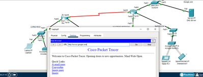

Hi
  Now you have internet. At least considering the limitation of the simulator. I added two servers more on the topology. One of them is a DNS server. DNS server is key when talking about internet. Whenn you go to your browser and type www.google.com the DNS server translate it to an IP address in order to the network devices undestand what the user want.
I also added another server which represent the Google site. You can go to any device, open the browser, type www.google.com that you are going to receive a simple page sent by the server called www.google.com
This is closest you can get for internet here on this simulator.

Hi
