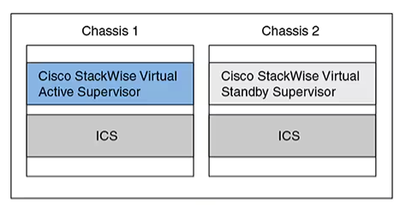

We are planning to do a failover test for C9600 stackwise virtual quad-sup, but not sure if there is anything we need to verify first.
Understand that in failover situation, the stackwise standby(chassis 2) should take over as active role in matter of seconds without traffic interruption.
Has anyone encounter these failover scenarios or performed these tests??

Thank you for replying. The reason for this test is because there was a failure in chassis 1 stackwise active-sup previously(probably power issue) and the stackwise hot-standby on chassis 2 did not take over as intended and eventually took about 15 min for ics(chassis 1) reboot to complete and take over the active role.
Currently:
#show redundancy rpr
sw 1 slot 3 - InChassis-Standby (Ready)
sw 1 slot 4 -  active
sw 2 slot 3 - STANDBY HOT
sw 2 slot 3 - InChassis-Standby (Ready)
So not sure what went wrong.
