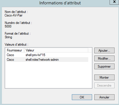

You need on your NPS another Cisco AV-Pair
shell:roles*network-admin
More details: https://www.cisco.com/c/en/us/support/docs/security/identity-services-engine/215525-use-radius-for-device-administration-wit.html

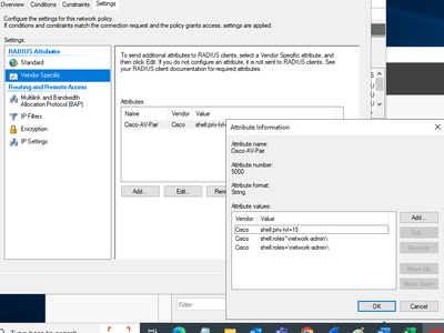

I have change the settings to the below. Still have a reduced level of management.

I am sorry but can you share good resolution image
you must use only network-admin not both.
the user either network-operator or admin here we need it to be admin
Cisco-AVPair = shell:roles=\network-operator network-admin\
OR select one that work for you not add both under attribute 5000
Cisco-AVPair = shell:roles*\network-operator network-admin\
thanks
MHM
I have removed the network operator but is this required as on the switch it states my account is a network-operator. Should this be matching on NPS and switch?
roles:network-operator
user:mike.allen_adm
the attribute 5000 is only for the role and it accept only one value
I see three value under the attribute 5000 , am I correct ?
Yes there are 3 values in the 5000 attribute. Should it only have the shell:roles*\network-admin\   and remove the priv 15 and other shell role value? I thought you could have more than one value in the 5000 attribute..
