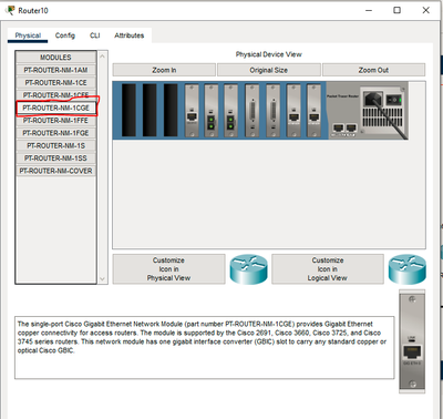

Hello, I have a lab exercise regarding NAT. Can anyone tell me which router model in Packet Tracer has the following ports: Fa0/0 and Gig0/2?

Usually the routers has either Fast or Giga interface. What you can do is install modules. You can use the RouterPT model and install the module  PT-ROUTER-NM-1CGE
M02@rt37
Hello @bokayle123
1841 Router is a common choice that offers a combination of Fast Ethernet and Gigabit Ethernet ports.
Power off the router and add the module card:
Power On the Router,, you will see the Giga interface
