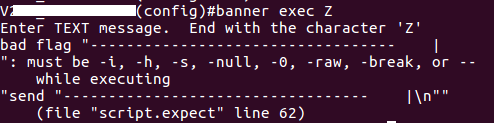

Hello, i would like to use except script to automated the configuration of my switches . I tried it's work well but i have somes errors with the banner.
Here is my script :
but i have this errors :
what's the problems ?

You should add -- after your send lines to prevent additional argument processing:
send -- ...
Instead of double-quotes, use {} as that is Tcl's way of doing literals without additional expansion:
send -- {This is my banner}
