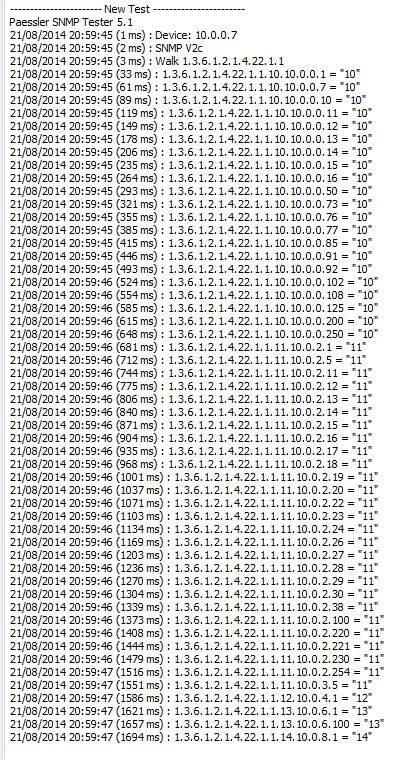

Thanks Vinod. I've found lots of people asking for the IP address connected to each interface but, like the links above, the answers always come back with the IP address OF the interface (i.e. VLAN gateway address) but I need to show a list of IPs AND which interface they can be found on, wheather directly connected or connected via another switch(s). I need to build a network map of what's connected to what, just like the rather expensive What's Up Gold does.
If I walk the OID 1.3.6.1.2.1.4.22.1 it seems to get close, but I think the indexes still refer to the VLAN id as opposed to the switchport id?
Thanks for the help ;)
