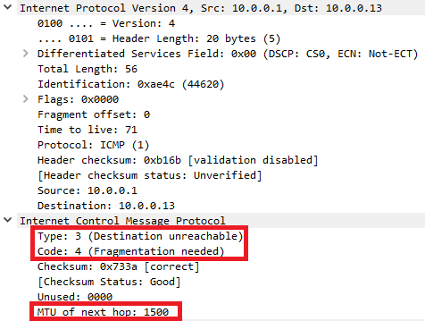

Now if your computer is able to send a packet larger than that of say your router's interface MTU, the router will send an ICMP Type 3, Code 4 which simply is the router's way of telling the computer that the packet was dropped because it was too big and couldn't fragment it.
The computer's output is slightly different in this case as well:
C:\Users\Tyson>ping -f -l 1475 8.8.8.8
Pinging 8.8.8.8 with 1475 bytes of data:
Reply from 10.0.0.1: Packet needs to be fragmented but DF set.
Ping statistics for 8.8.8.8:
    Packets: Sent = 4, Received = 1, Lost = 3 (75% loss),
Notice that only 1/4 packets made it. That's because after the computer received the first packet from the router telling it the packet was dropped due to not being able to fragment it, the other 3 packets were not even sent from the computer. The packet capture confirms this by only showing the outbound initial packet followed by the packet sourced from the router who could not fragment.

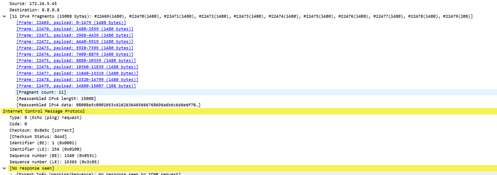

Another thing I just found that is I can ping my default gateway with a great value than 1472 and yes its fragments the packet with a greater datagram only for my default gateway.
and is fragmenting the packets for 8.8.8.8 as well still no reply..
That's why I like to run Wireshark sometimes just to make sure that my computer is sending the packets I think it is sending. As you were able to see, your 15000 byte ICMP echo request (that's big! lol) was being sent as 11 fragments which were all 1480 bytes long except the last one which was 208 bytes.
I too do not get responses when trying to ping 8.8.8.8 with an ICMP echo request that large. I suspect that somewhere along the path to Google DNS, there is something that is blocking ICMP from being that large (could be locked down to prevent DoS).
If I ping my default gateway with an ICMP echo that is 15000 bytes long, I do get a response and can verify just as you did that the large packet is fragmented into many smaller ones.
If there is DoS Attack prevention, then the ping command should not reply to us with an error instead of "Request Time out". As far as I know "Request time out" means the packet is reaching the destination but the destination is not responding. Because of this prevention, should we not get any other error? is it a limitation of the ping command?
