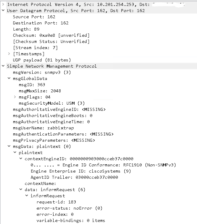

I'm also attaching screens from WireShark captures of sent and received packets between router-VM and NMS (Zabbix NMS with Net-SNMP's snmptrapd)
Sent SNMPv3 packet (from IOS-XRv):
Received SNMPv3 packet (from snmptrapd):

For comparison, I'm attaching working SNMPv3 Inform packet exchange:
Sent SNMPv3 packet (from vIOS):
