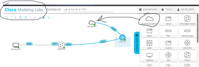

Good afternoon everyone, yesterday I tried to do a lab to test NAT but it doesn't work for me, any recommendation?
The pc takes ip from vlan 20

Configuration looks fine , Make sure interface Gi0/0 , obtaining IP address from DHCP from Internet Cloud .
sh ip it brief
sh ip nat trans
interface g0/0 if it has ip
only
ip route 0.0.0.0 0.0.0.0 interface g0/0
is need to forward traffic via g0/0 (NAT outside)
the command does not work
this only notify not error
now try ping from PC and check
It doesn't work
rajen.jakhar
Community Member
dont see vlan 20 is created on switch , are you able to ping gateway of pc ?
Can you Ping 192.168.20.1
Also you can try to ping from  router interrace ,
ping 8.8.8.8 source 192.168.20.1
and check sh ip nat trans
ping from pc to gateway vlan 20
ping from the router
nat
Could it be platform problem? i am using cisco modeling labs with this cloud as internet
can you ping 8.8.8.8 from router ??
I think the connection between router and Internet is failed
