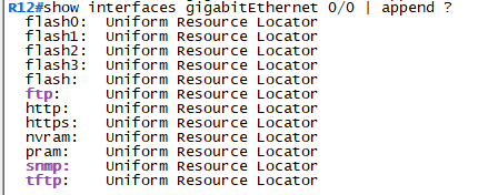

 The reason I am using "show clock" was because that was the only way I could figure to actually timestamp the output each time. My issue though is that each time the script runs I only end up with the latest output of the show clock. I believe this is because I am using "redirect" probably and not "append"? When I tried to use append I got an error that "Append is not supported by the file system" do you know what that means?
Not sure about the error, as long as the file is RW (read-write access to anyone) it will append the file end of each line.
