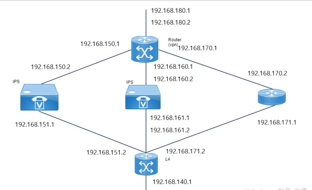

i built fwlb with 2 alteon l4 switchs(using LVS) and 2 ips(snort). (routing protocol is OSPF)
but... if two ips is  jammed, endpoint devices can't use internet.
 i wanted spare router for last resort.
so.. i built new router(on the far right) and routed ospf
suddenly.... problem happend !!       all packet passed by the new router!!even if icmp health check!! (it wasn't my intension)
i need that  the packets pass by two ips(with fwlb) and if ips die, new router activate itself.
how should i config the two l4 switchs?
