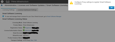

Hello, before Christmas Cisco has released Update 2 for Cisco Prime Infrastructure 3.10.4.
There is note which I am interested in how one can understand.
Here are release notes: https://www.cisco.com/c/en/us/td/docs/net_mgmt/prime/infrastructure/3-10-4/release_notes/Cisco_Prime_infrastructure_3_10_4_Release_Notes/bk_cisco_prime_infrastructure_3_10_4_release_notes-update02.html
Here is note:
Note
Ensure that proxy is enabled before registering the Smart Software Licensing.
Does it mean if customer did not have any proxy server at all, and Prime Infrastructure was working without any configured proxy server, that after this update 2, no matter what, customer has to install also some proxy server newly if he/she wants PI works with Smart Licensing CSSM again like before ?
When I am logged in after applying patch 2, the PI tells me configure proxy:
Previous direct option is missing now, so there is no choice to select something between proxy and nothing ...
I hope this is explainable and not yet another stupid bug.
I hope that the previous option has not now become an unreasonable condition.

I haven't tested this, but i find it not reasonable to force you to use a Proxy at all. I would expect that you should hit the internet directly if you don't enable proxy... Perhaps some clarification from TAC is needed.

release notes clearly state:
Important Notes
• Prime was migrated to Smart Receiver and as per their guidelines Direct and Transport Gateway mode
is notsupported. You must use Proxy to enable smart license using new url https://smartreceiver.cisco.com/
licservice/license
Cisco Prime Infrastructure 3.10.4 Update 02 Release Notes
so, it will be disappointing,
but if you do not have a proxy server in your environment, then update-2 is not suitable to be installed in your environment

first of all, this important note has appeared this week. By the time when I have installed the update at the end of previous year, such important notes were not yet there in release notes.
Second: there was good reason to install update-2 anyway, which was: CSCwh84581 HTTP/2 Rapid Reset Attack Affecting Cisco Products, we did not have any different choice.
So it is not nice from Cisco making such Updates pushes customers to the corner of no return.

TAC case is opened already.
It should be fixed in expected Update 03, still waiting....
stayd
Let me inform community, that it was never fixed in update 03 and I have just installed fresh vm with 3.10.5 where the Direct Transport option is missing. Due to this note:
Prime was migrated to Smart Receiver and as per their guidelines Direct and Transport Gateway mode is not supported. You must use Proxy to enable smart license using new url https://smartreceiver.cisco.com/licservice/license.
TAC case finished by patching some files with helping from TAC man, but as he said in next update, it will be rewritten these files by next patch again and you would return to the same situation.
So this requirement is still there and the solution which I have got from TAC was: switch back to traditional licensing if customer does not have any proxy server.
