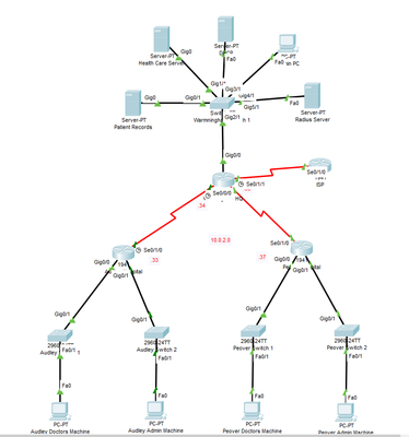

For my assignment I need to configure AAA on all routers (3 in total) there is a server dedicated for radius.
I assumed I had configured this correctly but can not get it to work on my main router.
I have attached my packet tracer file. Any usernames and passwords will be 'ADMIN' / 'cisco'

luis_cordova
Hi @daniel_growth ,
Make this changes:
On the AAA server, change the Client IP to 10.0.2.1(currently 10.0.2.34)
On the router run this command:
Warmingham-Router(config)#aaa authentication login default group radius local
Regards

Hey this worked perfectly but im not sure how to implement this on the 2 other routers. Is it the same config or different?
Kind Regards,
Daniel Growth
Hi @daniel_growth ,
It can be the same configuration.
You can even copy and paste what is already configured on the first router.
Remember the configuration of the VTY lines too.
On the server, the Client IP must be the IP of the interface closest to the server, where the packet leaves the router
