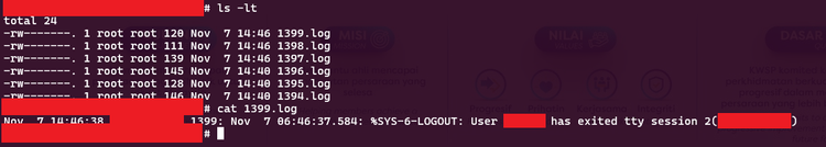

I have setup Cisco Catalyst 9200 to send log to syslog server and the syslog server manage to get the log. The only things that I didn't expect is the log appear in the syslog server is in a single log file for each line of log from the Catalyst switch. Is there any configuration we can do on the Catalyst 9200 to send the log to a same single log file? Below is the configuration done on the Catalyst 9200 and the example of the log file on the Syslog server.
logging host x.x.x.x transport tcp port 514
Thank you.

Hi @Kasun Bandara , thank you for your reply. I also setup for Nexus 9000 & Cisco APIC to push log to the same syslog server and the log appear only to one single same file.
Thank you.

To prevent headache on looking for solution on any configuration can be done on switch, what my Linux/Server team do was implement a script to run at the Syslog server (Linux) which it will compress all the files that was generate in the same day and keep it as a single file for a single day. If you found any solution can be done on switch, do reply to this Discussion Post. Thank you.
