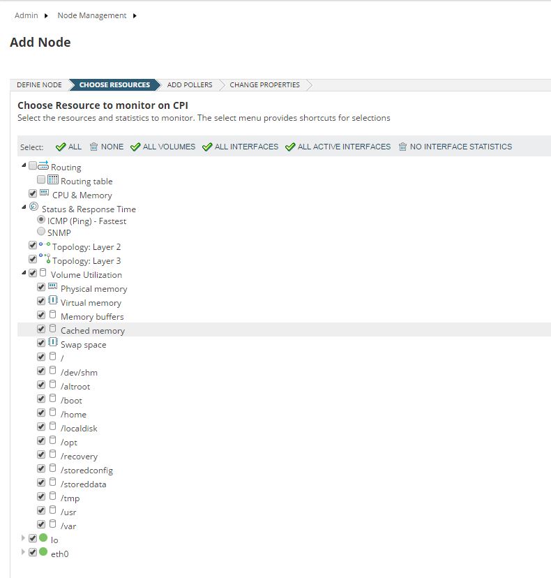

09-27-2016 03:53 PM
luijimen ,
Brilliant - thanks for the tip. I learned something new about PI today.
I used Luis' tip to successfully add my Prime Infrastructure to SolarWinds NPM as a managed node. I'm not sure it exposes process status via SNMP but it does provide a bunch of statistics that can be polled.
Here's what SolarWinds found when adding the node and how it looks as a managed node: (open images in new tab to zoom)
09-27-2016 06:25 PM
