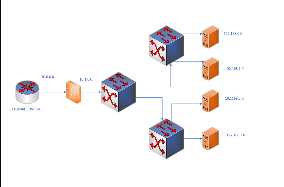

Screenshot 2025-02-04 102246.pngHi!
I have around 20 local networks. Im posting a basic topology with only 4 networks. Each server represents a network.
Everything internally is working fine. Nothing will be going out to the internet. This is all within house. Now there is a
client that needs to access these networks. We only want to allow certain network "10.0.0.0" on the client side to access internal networks.
So we added a firewall between the client and our network. We as well will need to access networks on the client end.
Question is do I need NAT for this? And how do I configure the ASA to allow Outbound traffic into our networks?

15 Replies 15
@mcast999 no you don't need NAT assuming each network can route to each other (either statics or routing). If there are no other NAT rules on the ASA then you don't need to configure anything, traffic would just be routed. However if you do have other NAT rules, you may need to configure a NAT exemption rule, to ensure this traffic is not unintentially translated.
You would need to configure ACL inbound on the outside interface to communicates with the internal networks.
I put:
access-list OUT-IN extended permit ip 10.0.0.0 255.255.255.0 any
int g0/0 (outside int)
access-group OUT-IN in interface outside
Cannot ping.
i am inspecting icmp
@mcast999 run packet-tracer and provide the output, example:-
"packet-tracer input outside tcp 10.0.0.10 3000 10.1.1.11 80"
