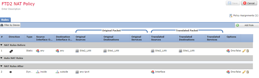

image.pngI thought the problem was the NAT policy so I configured as follows to try to get connectivity to work on FTD1:
And on FTD2:

I ran a trace and it says the traffic is allowed:
