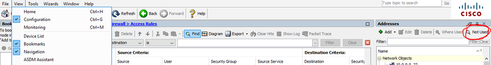

I assume this must be production network. if this is the case take extra care doing anything manual. must have a change control in place. If you using ASDM you can view the object/object-group if its used or not used (not required anymore as in your case).
to see what is "Not Used" you go (ASDM) into the "Configuration, Firewall" section and make sure you have turned on "View, Addresses". You should then see the "Not Used". This will display a new pop up windows list of not used object network/object-group you can delete them as it will give you the check list to select.

Hi Sheraz, thank you for your reply. This however relates more to just deleting the objects/network groups. My task is to delete unused rules on the ASA (hundreds of them). These are sent to me in an Excel sheet format.
