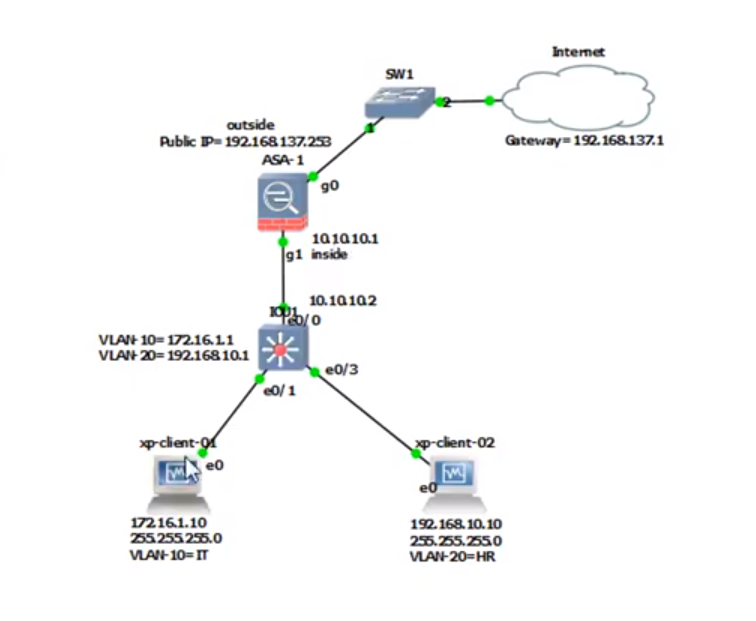

I've been trying to setup a simple network which has 1 firewall, 1 switch and 2 PCs. Please see the attachment for the topology.
My goal is that I want my PCs can ping 8.8.8.8 of the 'internet' switch (from my attachment). But  for now, they can't even ping 10.10.10.1 (firewall's inside interface) while these PCs can ping VLAN 10 ( 172.16.1.1) and vlan 20 ( 192.168.10.1) as well as 10.10.10.2. Any thoughts why these PCs can't ping the inside interface of firewall? Thanks alot.

balaji.bandi
Add below config in ASA
#icmp permit any inside
From SW3 are you able to ping to 10.10.10.1 ?

Hi Balagi,
Before add this command #icmp permit any inside, Yes, i could ping 10.10.10.1
Just now i tested your config in my lab (eve-ng) all works as expected, here is the results.

Suggest to save all config, restart the node and test it.
BB
It was the sw issue, saved the config and rebooted fix the problem. Thanks.
