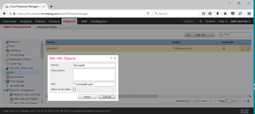

Firepower support wilcards in URL objects.
See the screenshot below taken from my FMC 6.2.2:
I can create an object but it doesn't work in access rules
