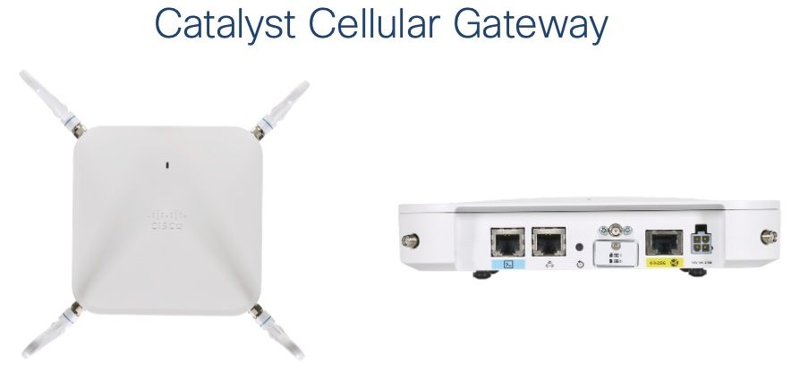

Let’s finally dive into the Catalyst Cellular Gateway, how it works, and what it has to offer for your WAN. The Catalyst Cellular Gateway can be connected to a router via an ethernet cable and placed anywhere in the building where there is strong cellular signal reception – for example, next to a window or mounted near the roof. You can use the provided indoor antennas or extend the antennas outdoors to the Cellular Gateway platform that is still indoors.
A DHCP client server relationship takes place between the Cellular Gateway operating as the server and network devices as the clients taking advantage of the wireless connection. The Cellular Gateway communicates with the service provider, receives an IP address, and passes it on to the router via DHCP to use on the WAN interface that it is connected to - therefore it is called an IP pass-through device. It's important to note that the Cellular Gateway and the connected router should be the only two devices in the VLAN if the facilities switching infrastructure is used.  Otherwise, a direct connect cable between the units will work and be able to deliver PoE power to the Cellular Gateway.
