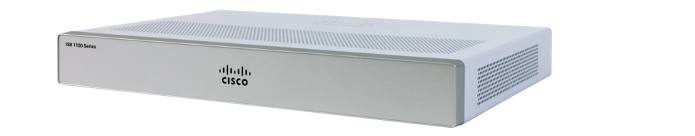

  • Cisco ISR 1000

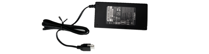

  •  External power supply

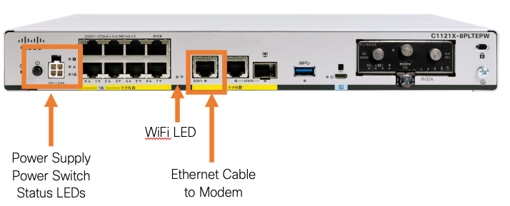

 1. Plug the ethernet cord into your router
Take the ethernet cord and plug it into the port labelled 0/0/1 on your router. Take the other end of your cord and connect it to your internet modem.

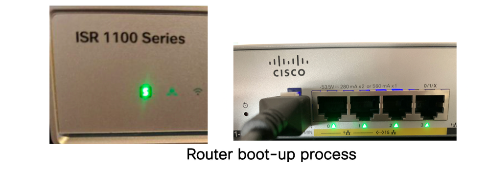

2. Plug in your external power supply
Using the power cord, plug in your router to an outlet. The LED marked “s” should now change to a solid green light. The lights on the switchport (4/8 LAN ports) will momentarily turn on and switch back off again.

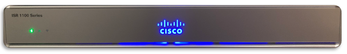

For older router models (111x and before), notice the Cisco logo light up with blue LEDs once the power is on.

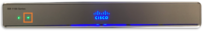

4. Upgrading your device
This may take up to 15 minutes. When the device is configured with the latest Cisco IOS image, check that the Wi-Fi LED on the router is ON with a blinking green light (may be located in a different area, based on your model).
