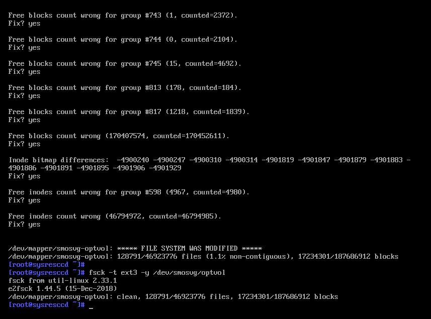

More than 6 years later, and this still saved my bacon. Was running PI 3.1 and for whatever reason ended up in a boot loop that was asking for a root password in order to run a File System Check:
We attempted to follow Cisco Document ID:200760, but the syntax was incorrect in multiple places. Still, even after finding a second article in the Cisco Community here stating that the syntax was incorrect in the first article, we still were at a loss, as the issue did not seem to be resolvable...by luck, a Google search returned the article on the page you are reading now. I used the Linux SystemRescueCd-6.0.2 Released on Feb 21, 2019, which you can download here: http://www.system-rescue-cd.org/Download/

From here, we can continue on with steps 8 through to completion. Not all of the output will look like what is posted above, but that's ok. I've posted mine for examples, yours may look a little different. I didn't show all of my volume fscks, because only one needed fixing.
As you can see above, I re-ran the fsck on the /dev/smosvg/optvol, and the second time it ran completely clean.
