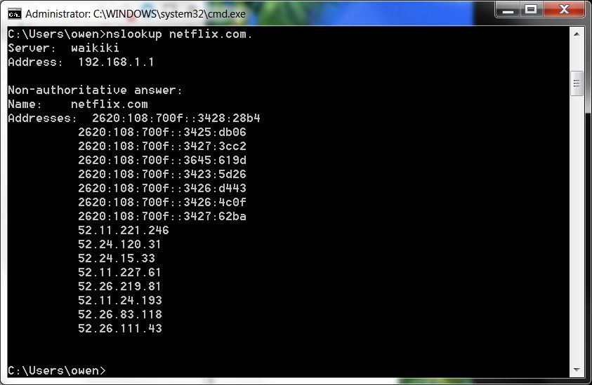

I can't seem to block netflix.com
usowl1
I added netflix.com to be blocked, but I can still access it.
Could you help?

Despite the configuration page you pasted, the diagnostic commands clearly show that your DNS traffic is going out via IPv6, which OpenDNS does not filter.
Perhaps whatever caused you not to be able to reach your routers home page reset the settings on your router, but if it is letting DNS traffic to go out via IPv6 OpenDNS will not work for you. You need to review the settingso n your router to make certain that IPv6 is disabled.

Regarding your last command output, this non-OpenDNS DNSv6 address is even not responding to any DNS queries at this time.  It would look like no internet connection at all.  And therefore Netflix seems to be blocked as everything else too.  It's  because you have disabled IPv6 on the router, but not so on the computer.  You must disable IPv6 on the computer too to prevent it from attempting IPv6.  Go into the network properties of your active connection and uncheck the box beside Internet Protocol Version 6.  Then confirm everything with "Ok".
Then try again with visiting http://welcome.opendns.com/ and maybe post the command outputs again:
nslookup -type=txt debug.opendns.com.
nslookup netflix.com.
nslookup www.netflix.com.

I can't access the router by using 192.168.1.1 which is what I have been using.  Even though I can access Internet
using chrome browser, when I type in your commands, I got those responses.
Even if I can disable my computer IPv6, I would also have to disable all other computers's IPv6 in the house.
That doesn't seem like a good solution for me.    To me this means no matter what I do to the router settings,
users can bypass those restrictions.  Is there any other way?

I disabled IPv6 on my computer, but I can still access netflix.com.
