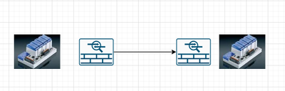

So, I have two process-plants each with a PLC and connected by to firewalls FRP1010 running ASA code (9.17.(1)). And CISCO VTI rote based VPN. So far so god. Everything works as expected. I can ping, use web and prosess traffic is flowing both directions. But when there is a disruption in the connection. Example a reboot for some equipment. Or a drop in the VPN, the SBUS communication does not start op again. Everything else starts up. I can even ping the equipment, but the S-BUS will still not initiate. We used to use policy-based VPN and I don`t recall having this problems then. This started when switched to route based VPN. The main log of the firewall does not indicate that packet are being dropped. Or that anything is out of function.
In the image below you can se a whireshark snip of the communication. We put the VTI interface in shut until the PLC reported communication error. As you can see it starts retry.
When we activate the interface again communication is restored but only one way.  The 10.141.0.0 are able to send data to the frontend at.10.130.0.0 but the front end is trying to reply but its dropped by the firewall
If we look at the conn table we find that the connection is registered and I have a feeling that this might be the core of the problem. Like there is a session mismatch. For when the tunnel Is taken down there is no tear-down of the connection. And the 10.130. will continue to send data. Once the communication Is restored, a “new” connection is established the opposite way and I get a mismatch resulting in communication not being able to flow.

I think your analysis of the issue is spot on. Are you running FTD ? You could configure a service policy for just that one service (UDP 5050) and configure a very short timeout, enable 'Reset Connection Upon Timeout' and also 'Detect Dead Connections'.

I think you need here EEM,
where in both side when the VTI is unreachable then clear conn.
this force the ASA to re-establish new UDP traffic.

Thanks for replying. Unfortunately session timeouts are of no use. The lowest settings on my ASA is 1min for UDP. The PLS pushes data more or less every second. I have tried setting the timeout as low as possible. But as mentioned it`never reaches the timeout limit.
So there is also switches and other equipment behind the firewall. So only relying on the status of the VTI would probly not work as well. Sins f.eks a switch or the firewall itself is rebooted.
A possible solution is to use EEM and drop connections every 4 min. (4min is the time taken before comm. failure alerts har sent out by SMS). But this again will risk missing important parameters that are sent continuously, so not really a good option.
Does the firewall handels this trafikk differently in policy mode? So that might be the solution?
I had a look at the manual: would it not be possible to set a timeout value somewhere in the PLC itself ?

With the policy-based VPN, what did you actually configure with regard to the PLC traffic ? Was UDP 5050 traffic encrypted or not ?
I`ll have a look at it with the PLC folks to se what what they come up with. Yes, UDP was defined as interesting trafikk and encrypted.
event manager applet PREEMPT
event syslog id 622001 occurs 2
action 1 cli command "clear local-host x.x.x.x"
output none
syslog id 622001
622001
Error Message %ASA-6-622001: string tracked route network mask address , distance number , table string , on interface interface-name
Explanation A tracked route has been added to or removed from a routing table, which means that the state of the tracked object has changed from up or down.
  • string —Adding or Removing
  • network —The network address
  • mask —The network mask
  • address —The gateway address
  • number —The route administrative distance
  • string —The routing table name
  • interface-name —The interface name as specified by the nameif command#
so we run track then using the track syslog id to trigger the action of clear local-host x.x.x.x << we only clear conn of host  x.x.x.x not all conn.
you can check clear local-host before decided to apply EEM.
