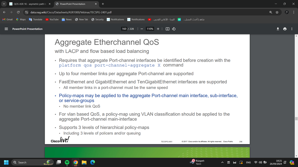

QoS in PO
QoS use in physical or virtual interface depend on type and direction
All those devices are switches.  OP is an ASR1k, router.  Router QoS is usually more capable than a switch's.
Also, this from a CiscoLive presentation?  Regardless, date of source?
this for ASR IOS XE
you can see the QoS can apply
A- member
B- main interface of PO
C- subinterface of PO
I share two slides for you and other to understand there is direction of QoS and type
and it decided in which interface you can config
MHM
