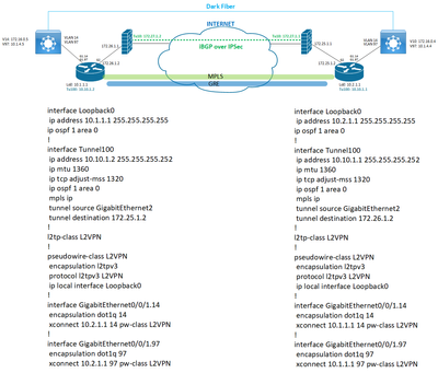

I have created the below network setup, trying to get VPLS running over GRE P-P tunnel. The GRE Tunnel is Up. MPLS seems working OK, I can ping from 172.16.18.0 to 172.16.160.0. However, VPLS comes Up (VC is Up) but doesn't forward traffic between sites withing VLAN 14 and VLAN 97. The "sh mpls forwarding" shows no outgoing interface for vfi 14 and vfi 97.
Do I miss anything in the config?

I've finally ended up with the below setup and deployed it on the real hardware (C1111-8P router). I've used L2TP instead of VPLS. For some reason the hardware doesn't allow STP BPDU through VPLS, however, it does allow STP BPDU through L2TP. I need this L2VPN as a redundant connection for the Dark Fiber we have between these two sites. So, if STP BPDU is not allowed through L2VPN it might be a potential for traffic loop. If you have any ideas to overcome this hardware limitation it would be very helpful, cause i prefer to have VPLS as L2VPN.
