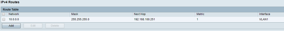

I have 2 small LANs - 192.168.100.0/24 and 10.0.0.0/24. The RV340W is the main router connected to the internet. It is the gateway for the 192.168.100.0/24 network and has a 192 address on the LAN side.
The 10.0.0.0/24 network is a small group of PCs - a workgroup - that run machinery.
I have a router between the networks. The WAN side is on the 192 network, and the LAN side is on the 10 network.
The 192 network needs to access the 10 network, but not vice versa.
So I set up a static route in the GUI of RV340W of 10.0.0.0/255.255.255.0, next hop is the router IP between the networks and metric is 1.
I can ping 10.0.0.1 on the other side, but I can't browse to it using \\10.0.0.1\. The Netgear router I took out worked flawlessly with these settings. Since I can ping it, I assume the routing is working, as I can remove it and I lose the reply. I assume a port or something?

So I am back to trying to figure out why it will not allow me to access shares across subnets, but I can ping and do tracerts to the server on the other subnet with my simple static route in place.
ANY input is appreciated. I can post any screen shots needed, but since this model has no console, I can't post a config.Capture.PNG192 to 10.PNG10 to 192.PNG

This is NOT an issue with RV340...if there was a issue with the RV340, the ping traffic between 192.168.100.x and 10.0.0.1 would not work at all...
As for the attempt to connect to the netbios-share \\10.0.0.1\......@Giuseppe you are very correct in the point that its the old-router that separates the 10.0.0.0/24 and the 192.168.100.0/24 network that is preventing the netbios-connection from happening....it needs to be applied the ip-helper-address and allow-netbios traffic forwarding
Again here there are some caveats
- if the windows machines in 192.168.100.x network accessing the netbios shares \\10.0.0.1\ are older machines then  the netbios connections would be using udp/137 and/or udp/138 ports.....
- Else if the windows-hosts are latest ones...then now a days all netbios-share access is done using Netbios-Over-TCP./Direct-Share...and this uses TCP/445 port....so basically this would be a TCP-connection from the 192.168.100.x host to the 10.0.0.1 across the old router...
- RV340 is just the default-gw and will just forward the packet to 10.0.0.x network on the same vlan1 interface to 192.168.100.251 the old-router interface...
- so in case if RV340 has to be involved in any denial of these netbios sessions...it would be becos there maybe be access-rules/firewall rules added on the RV340 by the admin denying/permiting traffic...on vlan1..
Another logical debugging would be to use wireshark/tcpdump on the old-router and/or use port-mirroring or something to see where the netbios session packets (either tcp/44 to 10.0.0.1 or udp/137/138...) are going and who is dropping ...
Should check with tcpdump or packet capture on old-router interface (facing the RC340-lan-segment) to see whether any of the netbios packets are arriving there (upto 192.168.110.251), if yes then its definitely a problem with old-router...
hope this is of some help...
