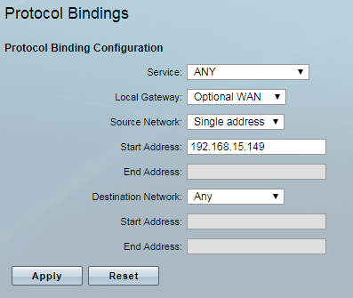

Hi Seb,
I followed your recomendation but no luck.
here is my configuration:
The 2nd hope should be 192.168.36.1 (WAN2).
I checked my ip over the internet, just in case it where related to the protocol but not, it is still showing my ISP WAN1 IP.
What am I missing here?
Hmm, How have you specified the source network, as a host? ie 192.168.15.149/32 ?

not possible, only: Any, Sigle or, Range. im trying with single, to check with mine
From your screenshot it looks like it should be working!
