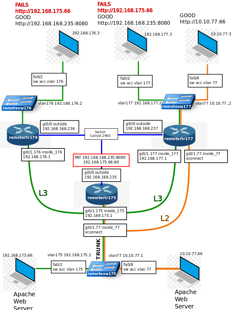

2921 router working example of a route-map - NEEDED
Hi does anyone have an example of a route-map that works on a 2921?  I have an issue with PAT and L3 tunnel that I'm hoping that route-map will help.
1) The L3 tunnel shows up at the distant end as the outside address instead of the private address.
2) The PAT blocks the inside address:port from working  through the L3 tunnel.
Here is the L3 tunnel and the route-map that did not work :-/  Thanks for your help.

I believe that there are 2 issues with the route map and acl as you have posted them
route-map NO_NAT_192.168.176.0 deny 10
match ip address DENY_NAT_192.168.176.0
ip access-list extended DENY_NAT_192.168.176.0
deny ip 192.168.176.0 0.0.0.255 192.168.175.0 0.0.0.255
deny ip 192.168.175.0 0.0.0.255 192.168.176.0 0.0.0.2
The first issue is that your route map statement is a deny and the acl that it references is also deny statements. If the route map statement is a deny then the acl statements must be permit if the traffic is not to be translated.
The second issue is that the route map is not permitting any traffic. Seems to me that after denying what should not be translated there should be something to permit and translate other traffic.

LOOKS TO ME LIKE inside AND outside ARE MIXED UP ?????

I tried to do just the opposite just to get the route-map to work.  It never opens the port 8888 on the outside interface?
I put a "deny ip any any" at the end just in case.  Still does not work.... but I can access 192.168.175.3 80 through the L3 tunnel.... :-0
CORRECTION wildcard instead of netmask ---------------opposite----------BUT STILL DOES NOT WORK
ip nat inside source static tcp 192.168.175.3 80 192.168.168.235 8888 route-map TEST_NAT_192.168.176.0 extendable
route-map TEST_NAT_192.168.176.0 permit 11
match ip address PERMIT_NAT_192.168.176.0
ip access-list extended PERMIT_NAT_192.168.176.0
permit ip 192.168.168.0 0.0.0.255 host 192.168.175.3
I trued to reverse it to permit but I still can't get it to work.

Hi Jon, I'm trying to get the 2921 to build a L3 tunnel to another 2921 and let the internet PAT the inside web server 80 by hitting the outside address on port 8888. The PAT does not let the remote PC access the web server 80 through the tunnel.
If you are trying to get a 2921 to build a tunnel to another 2921 then post the config of both 2921 and an explanation of the topology of the network (what is connected to what and how does the data from one 2921 get to the other 2921).

in addition to Richards's remarks, it would be useful to see the full configurations of both sides. Right now, it does not look like the NAT exclusion ACL and the crypto map ACL are mirrors of each other...
So if possible post the entire configs of both ends...
This may give some insight into why the 5520 works and the 2921 doesn't.
Here is an IPSEC tunnel between a ASA 5520 and RTR 2921.  Note how the 2921 comes out of the tunnel with the outside address, but the 5520 uses the inside addresses.  Attached are the configurations.
MY GUESS IS THAT ENCRYPTION IS NOT BEING DONE!!!!!

SESSION 3 #sh cry ipsec sa - on ASA and RTR - NOTE THAT THERE ARE NO encaps decaps SHOWING

I have not yet looked at the configs (and will do that later). But want to comment on the output that you post here. It is interesting and unexpected.
- ping from PC connected to ASA to PC connected to router is successful. (sends requests, receives responses)
- ping from PC connected to ASA sees request with source and destination as the PC addresses, but sees responses with source address as the translated address of the router. PC connected to router sees the incoming request with source address as the translated address from the ASA. So the ASA is translating the source address of the outgoing request, and the router is translating the source address of the outgoing response.
- ping from PC connected to router to PC connected to ASA fails. (sends requests, receives no responses)
- the ASA does not show any negotiated ipsec sa. The router does show a negotiated ipsec sa. But there are no encaps and no decaps.
- so the ping traffic is not being encrypted. And it works in only one direction.

I am not sure what is going on. But the posted configs do not match what is described. Your output describes an ASA with inside address 192.168.172.1 and outside address 192.168.168.232. The posted config for ASA has inside address 192.168.168.233 and outside address 68.106.145.92.

CORRECTION I updated the original posting (the one with all the funny pings) with the correct ASA configuration (RTR_ASA_L3_here.txt).  Sorry about that...
MESSED UP, BUT UT DIDN'T CHANGE ANYTHING The RTR tunnel is set up for crypto map CMAP on the OUTSIDE int... I still get the weird pings....
I had the same configuration on both the RTR and the ASA
RTR !
interface GigabitEthernet0/1.172
description INSIDE_172_to_ASA5520
encapsulation dot1Q 172
ip address 192.168.172.1 255.255.255.0
ip nat enable
ip virtual-reassembly in
ASA
nameif inside
security-level 100
