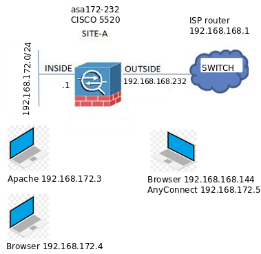

AnyConnect is working but I can't access the web server but ping works.  Attached is the full configuration.  I had to remove the nat to get it to work.
((( no nat (inside,outside) source static 192.168.172.0_24 192.168.172.0_24 destination static )))

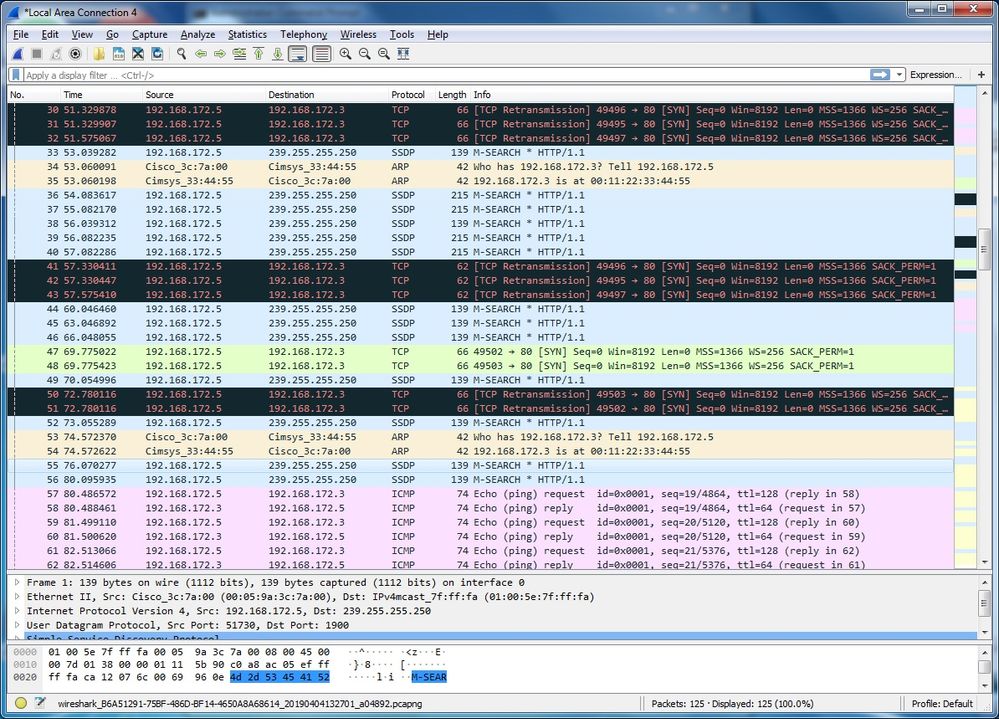

Here us the Wireshark on the client for the ping and http://192.168.172.3:80 (ping is at the bottom)
192.168.172.3<->192.168.172.5
Here is Wireshark for "telnet 192.167.172.3 80" it tries to connect then tries again.

the split tunnel ACL does not look right. It needs to specify the network of the inside interface. Instead of:
access-list SPLIT_TUNNEL standard permit 192.168.173.0 255.255.255.0
use

looking at your configuration it seems that your VPN pool is derived from the same network as your inside ?
ip local pool VPN_POOL 192.168.172.5-192.168.172.10 mask 255.255.255.0
interface GigabitEthernet0/1
nameif inside
security-level 100
ip address 192.168.172.1 255.255.255.0
Typically you would need a NAT exemption from the inside/local network to your VPN pool addresses. This is not possible as both are in the same network. Try and change the VPN pool to something different:
ip local pool VPN_POOL 192.168.173.5-192.168.173.10 mask 255.255.255.0
and then add a network object for the pool, and the NAT exemption:
object network 192.168.173.0_24
subnet 192.168.173.0 255.255.255.0
nat (inside,outside) source static 192.168.172.0_24 192.168.172.0_24 destination static 192.168.173.0_24 192.168.173.0_24
Hi Grorg, Thank you for your recommendation.  I entered the configuration that you suggested into the ASA firewall, it went in OK and the AnyConnect client runs OK, but it doesn't work.  The ASA firewall that I'm using to get into the enclave is not the default-router used to get to the internet.  The AnyConnect client connects but the default-router is blank, like this "Default Gateway  . . . . . . .::"   How does the client route from the AnyConnect network, 192.1687.173.0, through the ASA outside interface, 192,.168.168.232, to the ASA inside network 192.168.172.0?
When I ping from the client to inside of the AnyConnect connection, the ping goes out the wrong Ethernet Adapter.  The main NIC is used, Ethernet adapter Local Area Connection, instead of the AnyConnect NIC, Ethernet adapter Local Area Connection 4?  See the following.

There are now tunnels from the command "sh cry ipsec sa"
Note that I had to remove the overload nat to get anyconnect to work (when I was using the same network for the inside and the anyconnect pool. "nat (inside,outside) after-auto source dynamic any interface"  This is the nat that worked with the PAT, L3 tunnels, and the overload nat to the internet.
Here are the NATs that play well with others :-)
use
access-list SPLIT_TUNNEL standard permit 192.168.172.0 255.255.255.0
Also, add the words in bold to your NAT exemption:
nat (inside,outside) source static 192.168.172.0_24 192.168.172.0_24 destination static 192.168.173.0_24 192.168.173.0_24 no-proxy-arp route-lookup
WOW it works!!! Everything works - but I haven't tested the L3 tunnel yet.  I have to build up another 5505.  But NAT overload, PAT outside:8080 to inside:80, VPN Anyconnect all work.
You're the best Georg.  Thank you for your time once again.
