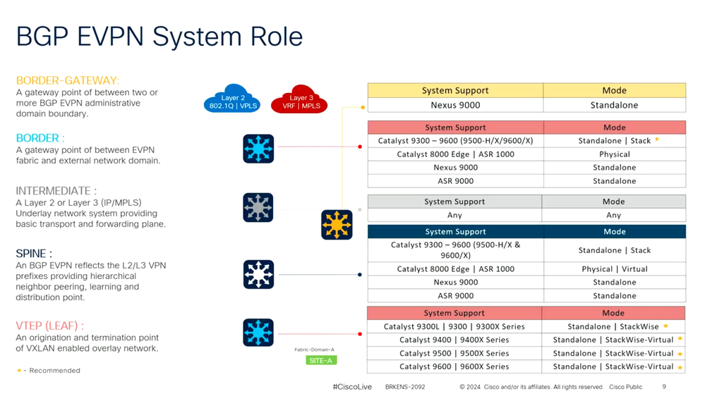

please check this
you can not use any SW as border GW
MHM
I don't know what you trying to say here with this diagram. What SW as border GW ?
Like campus' the vxlan use
Leaf and spine and border GW'
Border GW is use to connect your DC to other DC.
You mention about full bgp table linitation and I try to explain that only specific SW can work as border GW of vxlan.
MHM
