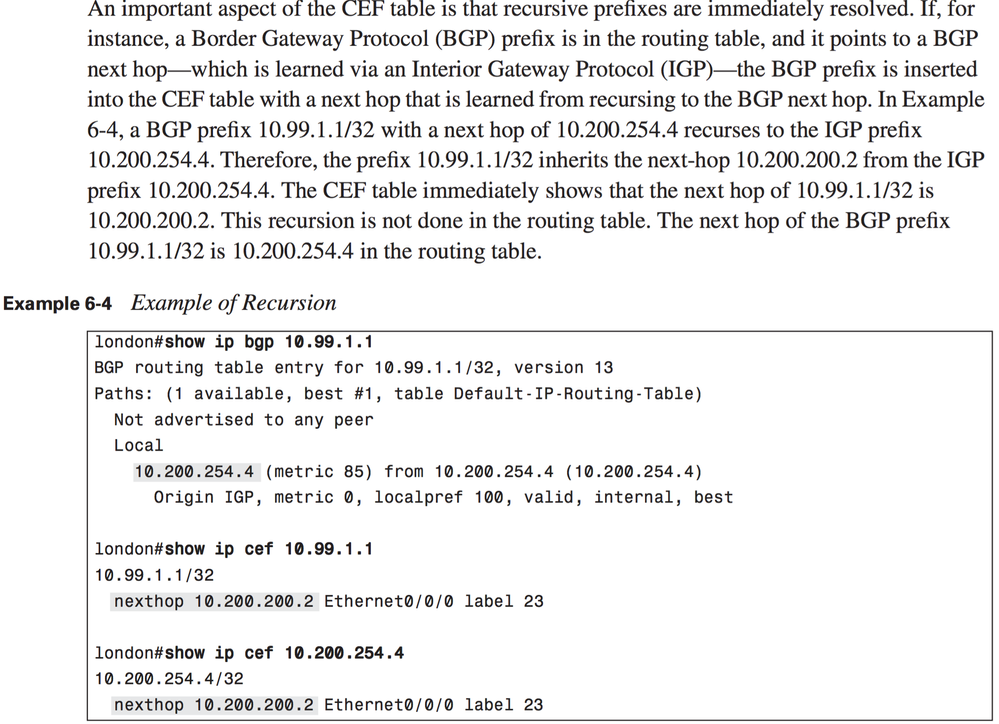

balaji.bandi
Load balancing over the multipaths is performed by CEF. CEF load balancing is configured on a per-packet round robin or on a per session (source and destination pair) basis.
below guide help more understanding :
https://www.cisco.com/c/en/us/td/docs/ios/12_2sx/feature/guide/fsxeibmp.html
BB
